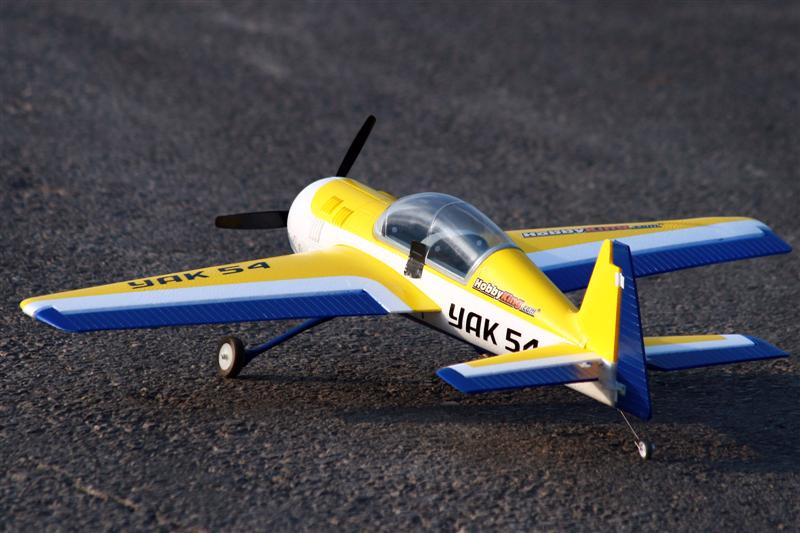

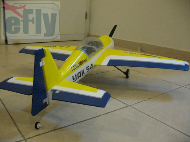

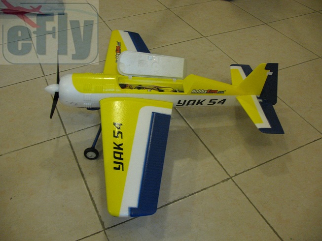

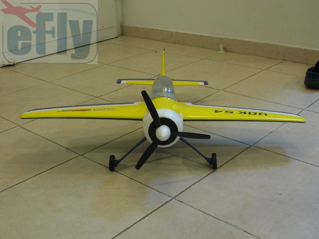

    Recently hobbyKing introduced a new product : "HobbyKing YAK 54 Brushless EPO Plug-n-Fly". This plane is not meant for beginners, it applies to the more experienced flyers for 3D flight and aerobatic flight. According to hobbyKing this plane was designed from scratch making it lighter and
    suitable for 3D flights.

    Wing Span: 750mm (29.5in)
    Length: 675mm (26.5in)
    Weight: 355g (without battery and receiver) Battery compartment size: 99x39x16mm (Important) center of gravity : 52-60 mm behind the wing leading edge
    Not supplied : Your TX & RX
    7.4V 2S 1000mah lipo battery I used this battery.
    For the advanced pilots - 11.1V 3S 760mha Lipo battery- This will do fine.

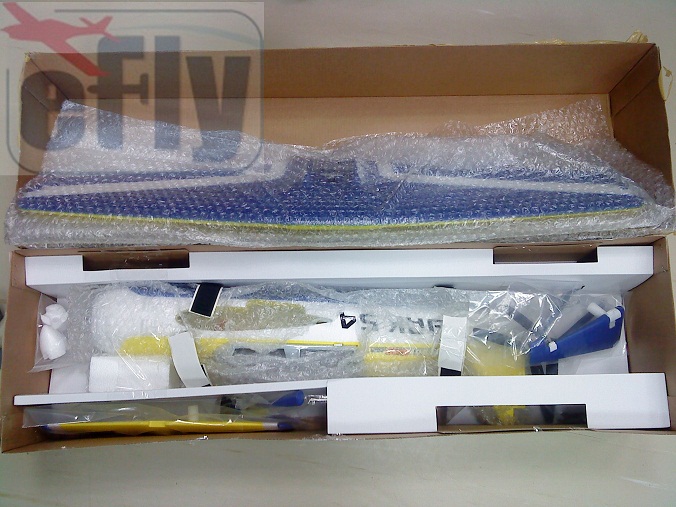

    The plane arrived in a blank cardboard box. inside the box there were two layers of bubble wrap and beneath, also wrapped in bubble wrap the wings. I should point out that the two wings are made in one piece, what should increase the wings durability. The rest of the pieces were tightly secured beneath the wings. Overall, It seems that Hobby King did their best to secure everything in order to avoid damage during the voyage to the holy land, a good example for this is the horns that came wrapped in a thin sheet of foam to protect them. HobbyKing took the ecologic approach and didn’t
    supplly any hard copy instruction manual .
    Delivery time: It took 14 days from the moment of ordering until the arrival of the plane (Shipping method- Air Parcel (Israel) up to 2kg).

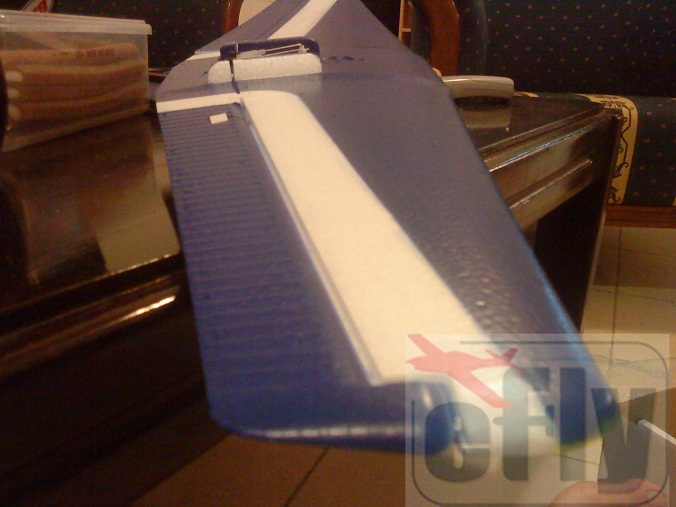

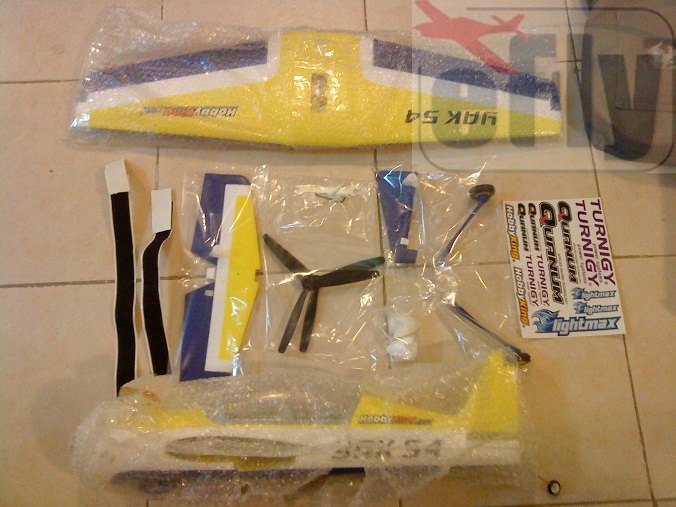

    1. The body of the plane with an ESC motor and two servos already mounted with push rods.
    2. One centreral wing with servo mounted as well.
    3. Rudder and elevator attached with horns .
    4. two 40mm (1.5 inch) foam wheels on landing gear .
    5. Two EPO spinners.
    6.two 8X6 3 blades propeller.
    7. Plastic bag with one Hex key),two spare clevis, two nylon screws (for wing assembly) ,one metal bolt (for elevator assembly) , and one small wrench which I didn’t use.

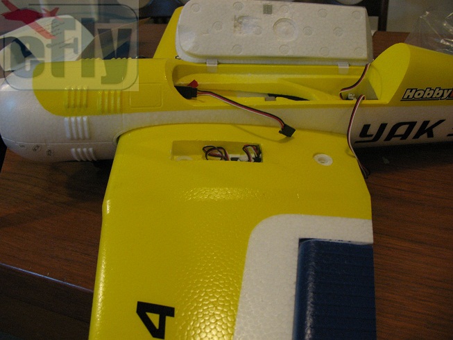

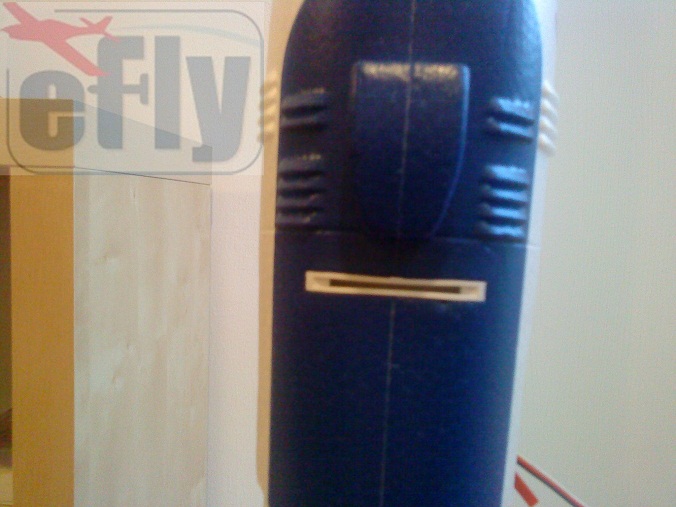

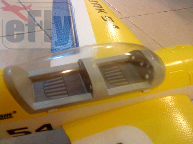

    The airframe seems of a high standard, all the parts are fit together in harmony. I couldn't notice any defects with my naked eye. Again Hobbyking insist on the minor details The plane seems and was decorated as a real plane and not like flying foam. The body has an air inlet that is not only pretty, but actually cools the ESC. Moreover since trying to give this plane a scale look the accessibility of the motor is impaired (not clear senetece) . What compromised the lack of accessibility is a small hole in belly that allows removing the motor from its base. The hinges of the rudder are very elegant and the rear wheels attachment seem robust. The plane has a very realistic appearance due to the ailerons system that doesn't have any horns. Furthermore the canopy hatch can be easily open and close thanks to the two plastic hinges and the magnetic bolt.

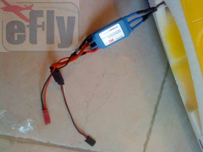

    The electricity of the plane seems to be consisted from a 2409-18T motor attached with 3.5 bullet connectors to the ESC. The ESC- battery plug is JST connector. There are three 5 grams servos, all the servos are accessible and can be replace by removing two small metal screws, in case of
    malfunction.

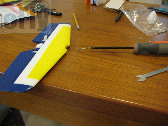

    Step 1- Attaching the elevator to the main body:

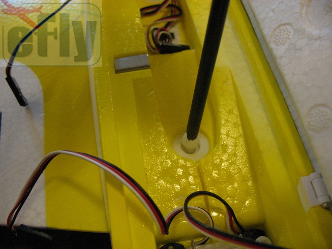

    In the elevator there is a small groove that enters the body to ensure proper orientation. You just need to remember to attach the elevator when the horn is facing down. After you connect it,just screw the metal bolt until the elevator is tightly secure in its place. (Use a proper screwdriver).

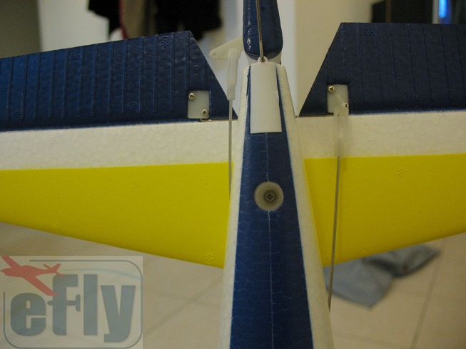

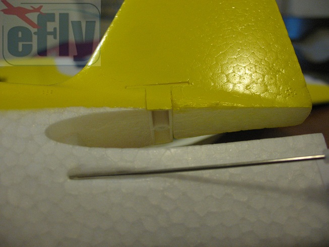

    Step 2 horizontal stabilizers:
    Just push the horizontal stabilizer into two plastic hinges until you here click! You will need to take care while inserting the wired loop into the plastic cavity (I really liked this method, its gives the back wheel the toughness to
    endure hard landings.

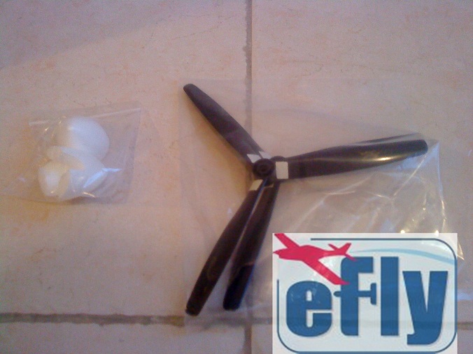

    Step 4 : propeller assembly.
    Make sure the two side stickers are facing forward to the direction of the flight. After the propeller is secure peel the cover of the sticker and attach the EPO spinner firmly.
